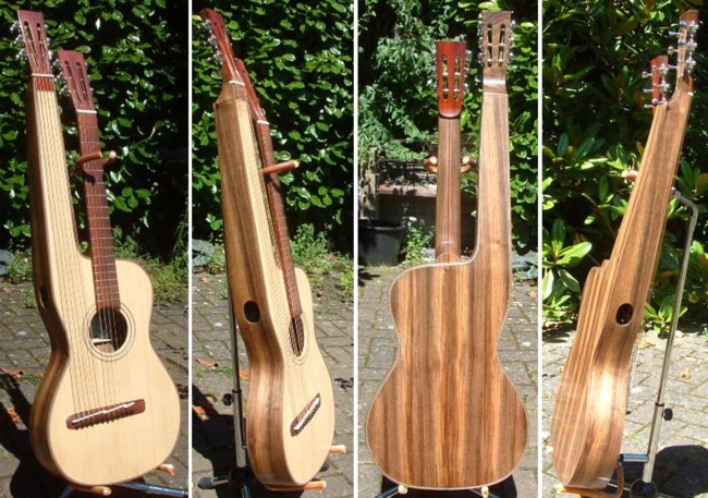

Jacob ladder braced harp guitar with 6 sub-bass strings– 4 piece Lutz spruce top, 6 piece English walnut back, English walnut sides and bindings with bwb side purfling and bwbbwb top and back purfling. Rosette is twin circles of bwbbwb. Neck is English walnut /Cuban mahogany /EIR/ Cuban mahogany / English walnut with scarfe joint, stacked heel, and adjustable neck joint. Fingerboard, bridge, tail wedge, headstocks and backstrap veneers are cocobolo. Ebony bridgepins and slotted bridge. 3 bone saddles and 2 bone nuts. Hollow arm peghead is English walnut. Gotoh slothead tuners. Side-soundport. Finish is hand-rubbed pre-catalysed lacquer over Z-poxy on the back and sides and over shellac on the top. Neck is Tru-oil over Z-poxy. Tuning: F G A Bb C D D A D G A D. String gauges: 0.070”, 0.070”, 0.062”, 0.059”, 0.053”, 0.053”, 0.042”, 0.032”, 0.024”, 0.016”, 0.012”. Scale length 24.6” and sub-basses approx. 28”.
I’m very pleased with the sound – the combination of hollow arm, side soundport and sympathetic sub-basses means that it sounds like I am playing inside a church or cathedral with the built in reverb and the rumble and punch I get in my belly from the back is very satisfying. The bottom 2 sub-basses are a little floppy but this was as big a string that I currently want to use. With some K&K mini’s installed it will sound great. This is a very light and compact guitar but I’m still working out the “string geography” and it will take me a long time to work out how to play it to get the most out of the sub-basses.Also the tuning possibilities are pretty huge It got it’s debut at Folk Club Night at Burwell (my annual summer treat) last week:

Dave, that is truly beautiful in looks and sound.  Very complex tonally.  The playing is nice too.
PostPosted: Tue Aug 07, 2007 2:50 am
Dave as I said before fabulous guitar, just got to love having two slotheads on one guitar and three saddles! Sounds good and as usual your playing brings out the best in it.
You can always be relied upon to build an ultra niche guitar. Now you've just got to build the case.
You could spend a whole lifetime of playing and still not cover all of the alternative tunings and string gauges.

Kirby - I think knife-edge is a great description and is where I aim for on my instruments. I treat bracing as much as a friend rather than a structural nuicance. It's there as much to shape the sound as much as it is to structurally support. I thik subtle changes have subtle impacts but I always "voice" my toops the same way - carve and sand until I have ringing sustain just about everywhere - including the upper bout area which is only tonally dead if you want to make it that way. Thinking gets you only so far, having the wood in your hands and doing/making is the only real way to learn.
Rick - thanks. That means a lot coming from you. This is really my first "sighting shot" with this sort of instrument and I wanted to explore small/ladder bracing and so the double slothead was just perfect. Also I'm so used to moving between tunings that my fingers and ears work just as quickly as levers and as well for me. I have a proper Lutz harp set from Shane waiting to do a "real" harp guitar at some stage and the prospect of changing sub-bass tunings mid-tune could be interesting so the sharpening levers may be included. These instruments could be very addictive
